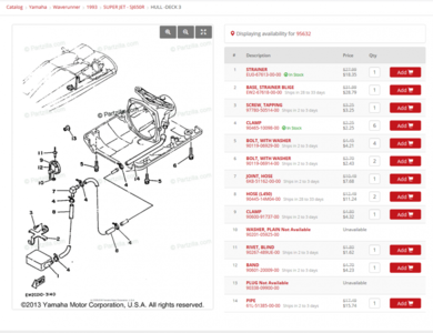

I noticed that I will need the bilge hose and the coolant hose (on either side on the pump outside the hull). I did some looking and the bilge one is referred to as a “pipe” and trying to find that part number for sale on eBay has proved difficult. The other one was referred to as a “hose” but when looking up the part number I just find bags of hose 2ft long or so withe name Yamaha on it. Are these two lines special molded to a certain shape or should I just get some standard line from my hardware store and hook it up?
Are you talking about the rubber lines that go from the hull fittings to the pump? If so, then just good rubber lines will do, I forget the size, maybe 3/8”.
Yes I am, thanks
Why don't you just buy it from Partzilla.com? "Pipe" is available for $15.74 and hose is available for $11.24

Personally, I try to use OEM stuff for this, because it has the flexibility that Yamaha wanted in their design. You would hate it if by turning your pump nozzle left and right a stiffer hose actually broke off the nipple of the metal pipe which goes through the hull.
But that is just me. I worry about stuff like that. And I like to do things only once if possible. And I don't worry as much when I use OEM,
And BTW, might as well take inventory of all the OEM little parts you want because it takes forever to get parts from partzilla.com
So, I would check with @JetManiac and @john zigler and see if they have them in stock because they are much quicker.
The hose doesn’t turn with the nozzle. It is attached the the outlet nozzle that’s stationary.

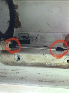

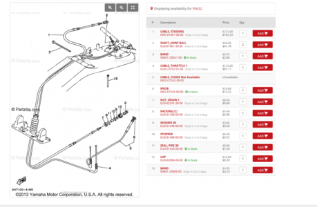

Anyone know if these seals are available to buy anywhere? On the prts diagram they appear to not be called out. The only “seal” called out on the diagram appears to be the one behind the nut and is listed as a “pipe seal”. Really hope I can buy these instead of buying a whole new cable. The cable came with the hull and appears really nice besides the cracked seals. I will also need the seals for the pole side as well.
Thanks!

Ok I get it.
(I am just learning jet skis, so don't rely on me.)
But there are vacuum line caps (not plugs) which come in both poly and in rubber and in various diameters from 1/16" to 1"
So, you might try sourcing those if you are going to rebuild your steering cable.
https://www.ebay.com/itm/Intake-Man...751812?hash=item3f911106c4:g:GqgAAOSw0A9aM-ZR
