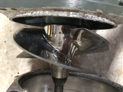

I've had the impros 9-17 hooker, the Skat Super Slim line 14-18, and the Solas in the photo. I like the Skat best. The Skat hits better than the Solas and is about half the weight. Everyone raves about the impros. I thought it hooked up a bit better on the bottom but fell off midrange, and went back to the Skat. If you are running a mod ski, then you probably have a different outcome, but for a stocker, old school is the best school. Likewise, the deep scoop grates are too aggressive...go with jet dynamics or an older Riva Tri loader. Make sure the back of the prop isn't bent, if it ate a rock, sometimes it will bend a prop on the way out. Impros or Skat will rebuild-re weld a rocked prop so it isn't fatal and cheaper than new. I've used both and the rebuilt prop is a-ok.
I've become prop paranoid over the years...my ride area isn't a pretty sand beach, there are lots of rocks, so my ski never hits ground any more.
