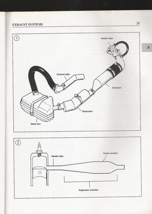

http://www.vf750fd.com/blurbs/stroke.html
Mixture Extraction
This pulse is timed to reach the exhaust port after the transfer ports close, but before the exhaust port closes. The returning compression wave pushes the mixture drawn into the header by the negative pressure wave back into the cylinder, thus supercharging (a bigger charge than normal) the engine. The straight section of pipe between the two cones exists to ensure that the positive waves reaches the exhaust port at the correct time:
get a clue.
not to mention the fact that those old '70's manuals were around long before you ever had anything to do with the stuff. I can tell by how much you don't know.....lol
