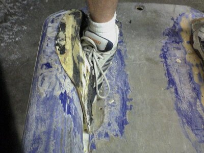

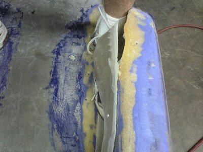

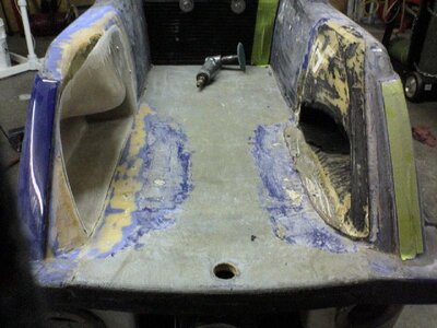

Here are a few pictures the left foot is the Waterdog and the right foot is the 24-7 (2002) bindings. The 24-7's are about 5 years old so their new design is much more comfortable than the old set that I have and more secure at holding you in.
The footholds feel pretty loose but but you can't put the 25mm padding under the 24-7 holds or the 8mm on top they are too tight for shoes(which I always wear) These will have enough room for the 8 on top and bottom with the turf so when you get in them you will be set. And they are deep enough I think you can put 2 layers of 8mm padding on the inside lip of the top to keep you foot from coming out sideways expecially after you cut a footprint out of the 25mm padding.
Here are the pictures before the fiberglass so ignore the giant hole on top that is where the old 24-7's wraped across the top of the ski. And the old 24-7 is in need of a clean up so don't pay attention to that. And I some how lost the 4th picture of me in them from the rear stupid cell phones

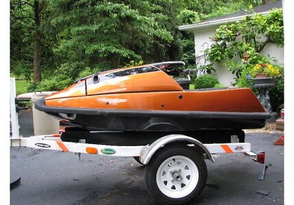

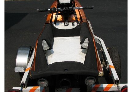

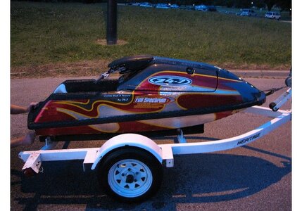

Just got done turfing my buddies boat yesterday and we took it out tonight. He loves the waterdawg R.E.V. holds and so do I. Very supportive and comfortable. His 24/7 ski is the R.E.V. holds and mine are the X-holds which are just a little bigger.

Thanks, I need to fix some carb issues but then I'll be on the water :biggthumpup:
I can't wait to run them side by side. They are similar setups but have different parts and layouts. He has Full specs and RAD valves, I have OEM 44 w/o the choke and V-force; his was ported by RIVA, mine by Magoo; both have lightened flywheels; his impeller is cut back and running a stubby cone, I'm running a concord with a blueprinted pump, stubby cone and bored nozzel. His is a round, mine is a squarenose; he is running a AC pole, I'm running a carbon/kevlar XFT. He has REV holds I have the X-holds. You get the idea. Similar but we went different directions as far as porting and combinations of mods. My money is that the squarenose will hit just a bit harder. The cases are ported and the motor is new. Nice to have anouther ski with a similar set up to compare mine with. His still looks better by far......Maros at 24/7 is the man!! So is Jeff at Waterdawgs, both sets of holds are awsome and extremely comfortable.

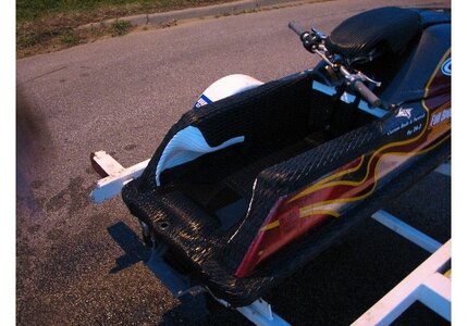

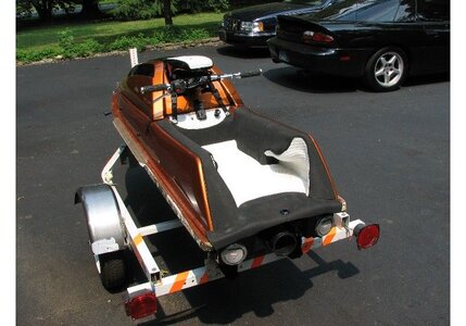

My superjet with Universal Footholds,
I rode these on Monday, and they were beyond comfy with minimal padding.
