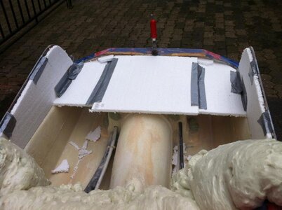

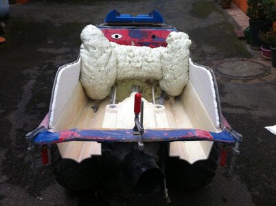

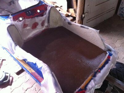

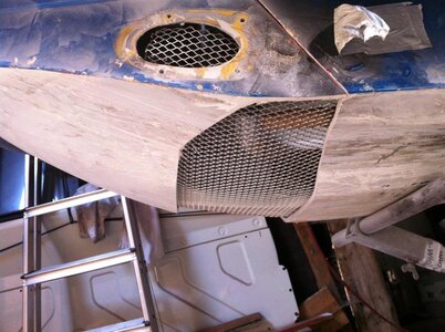

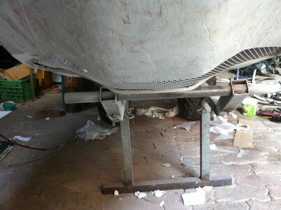

Some work done in the back. I Want to do a little stage under the footholds in the back. I dont know if it work, but ill try it.
Europa
Yeah
But i want it like this ;)
What do you guys think about the stage under the footholds, is ist better to make a flat tray?

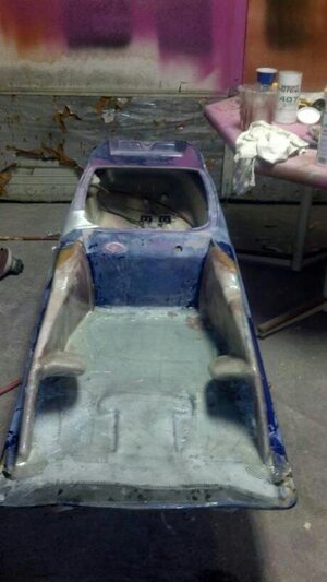

I lowered my tray almost 3 in.
So in my tray, my feet are lower than the pump tunnel, and slightly angled toe high, When they are locked into my foot holds. I love the way she rides with a lower center of gravity.

^^^^ Thats pretty cool!

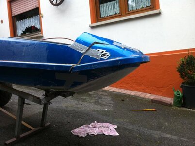

I see the rocker.....
And i'm like....
And....
New Name is like....
Chop it up dude... its just fiberglass... evil evil fiberglass....

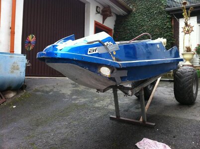

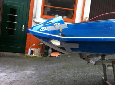

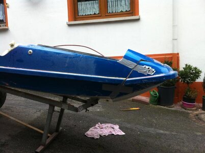

THe basic form is given, only putting it together and so some glasswork. I dont know if its enough rocker, but i think so...

Seriously.... The amount of rocker is ok, but I'm concerned about the blend into the bottom of the hull. Seems like a very abrupt change. Just my opinion. High five for cutting it with abandon!
Europa
Hi
its a Lot of work @ the nose. The bottom will get Smooth. Just Need to Cut of a Little Bit more, and
fill the room between. I wanted to have the nose original in the Upper Part. The bottom is easier to rebuild i Hope.
Lets try ist :)
Nah, once he get's all the glass and filler on the bottom, it will look like it should. Wish I had another hull to cut up over this winter! Making me jealous...

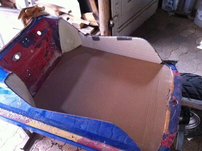

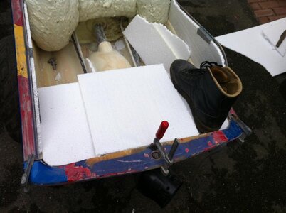

I did some more work today. I worked on the Tray, to get the basic Form. The front Foothold i shaped out of the foam look like s hit.
I dont need it, if it look so bad

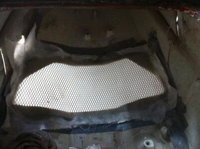

In the front, i worked on the 2 pieces. I cut out the bottom like i want it. I really dont know if its right, but i think it will work.
I just do 1 Layer inside the ski, and tomorrow i will fill it from the other side with gfk and many many layers that i get the old strenght.
After that i will lay some gfk from the inside to make it really hart.
Lets see if it work.
I keep on working.
Mfg

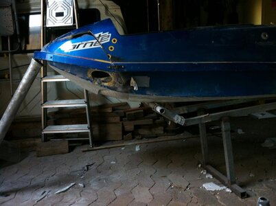

Looks like you have it around the same slope that my blaster has, I think you'll be happy with it like that. Looking good!
