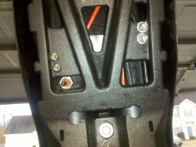

I made up another batch of switches today including some with 9ft leads so they can be mounted on the handpole somewhere.
I made a pretty simple mount for my RRP Pole but there are far too many different steering setups out there to make one that fits everything. I'm actually interested in seeing what others think.
IMG_20110102_162214.jpgIMG_20110102_162221.jpgIMG_20110102_163718.jpgIMG_20110102_163725.jpg

I'm having trouble mounting mine through my bulkhead on my roundnose. There's not enough threads to make it through the bulkhead and turf. Any tips
OCD Solutions
Rentz, GA
The bulkhead is thicker on some skis for sure. First try using an oversize socket or nut driver to compress the turf around the switch. If you can't compress the turf enough, it may be necessary to remove some of the material from the backside of the bulkhead. If you have one available, a mini die grinder with a 2" sanding disc works perfect; just don't take so much that you weaken the bulkhead.
I have the bulkhead, turf and a Blowsion guard on my current switches and I was able to compress the turf down enough to get the nut on.
