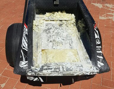

Has any one had problems where the tray area joins the engine bay self destructing two of my freinds have had this problem and im worried that mine will too.both have had large cracks where the join is and then the tray becomes water logged
x2mafia
Maximum effort
WA
@Aussie mick You should post pictures of where it happens so we can keep an eye out. Mine is fully torn down right now I'd like to look into it.
Resized_20161209_144606.jpeg the main problem with this ski was we're the tray joins the firewall the other predator well it was not joined properly from the factory and he's had all sorts of problems getting warrenty.i spouse it like everything you get what you pay for . it's a pitty because they are a great hull just lack a bit of quality control . as a aussie id like to see krash do well and think sometimes if he could fix some of the issues krash skis have his company would be extremely successful
Yes under the front foot part the other hull was pressure tested and pretty much leak everwhere around the tray joins . yes all of our hulls where built in Thailand .

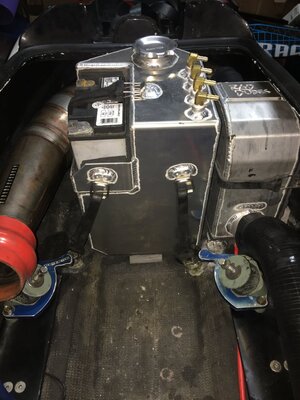

Hey just wondering if anyone has put a TNT V2/3 pipe in a Predator?
If so can you please put up some pics. want to see the fit and what tank I might need. Cheers.
x2mafia
Maximum effort
WA
TNT v2 fits good. You have to trim your pole breather tubes down a bit so they don't stick down to far.
