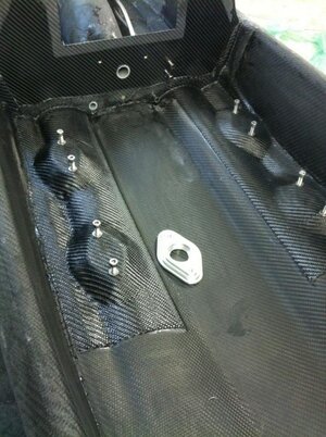

Here is a a shot of the motor mounts n bulk head area. Stainless 316 tubing, Billet motor mounts as usual but wrapped in glass to corrosion away. Tomorrow brings pipe mounts battery box and kart tank base install. ImageUploadedByTapatalk1364605171.668368.jpg

looks great. I was gonna skip wavedaze this year but these carbon brawlers and the new true performance motors have just about changed my mind. I just can't stand it!!! I gotta know! lol
