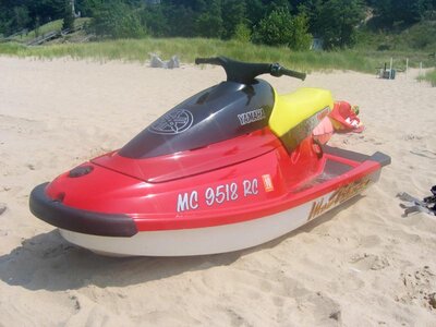

I've had good luck with Duplicolor Acrylic Enamel. If you put it on thick enough it ends up real glossy with no sanding or buffing needed, just wax and go. If you screw up the finish you can always fix it by doing this tho. They said this type is resistant to gas, but if you spill some on it you will have to rewax. Not sure if that is because of the wax or the paint but it's not a big deal. It holds up to scratches and chips as good as the oem yami smc paint if not better. I have seen it attack and peel up the oem paint so I always strip that off first.
Here are some sample pics, the red part of the hood is shown as sprayed, the black was color sanded and polished:
