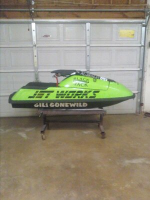

Here is wut I did, cleaned hull real good, sanded with 600 for about 30 minutes total, wiped down w/acetone, 2 cans of primer, wetsanded w/1000 for about 15 minutes, wiped down w/acetone again, 2 cans of appliance epoxy black, waxed the crap out of the sides to get a glowing finish.
disclaimer-it has not been in the water yet and may all fall off the 1st time I gas it. lol

nothing better than an aftermarket hull, billet cylinder and a rattle can paintjob!
Ill probably change it up after daytona, its getting scuffed up but has held great for over a year!

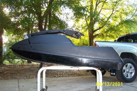

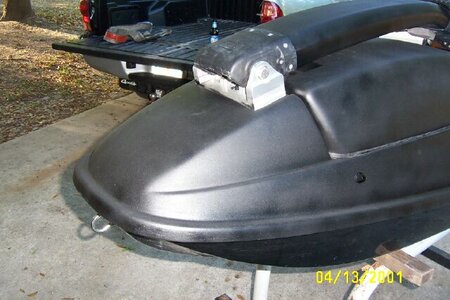

I think I have three coats into this... by the time I was done with one coat, where I had started was already tacky so I would start the second coat (I was in a warmer basement). Sides of the ski were fine. Did all the coats at once. My only issue with running was on the hood where the handle pole galley is (which you can't see when the pole is down anyway). I applied the paint to thick in that area.
There was no paint underneath - I sanded the glossy finish off the stock upper deck then brushed. It is a teflon based paint - overall held up great. The couple scratches that did occur was from me dropping tools on it, etc. Touches up in a second.
