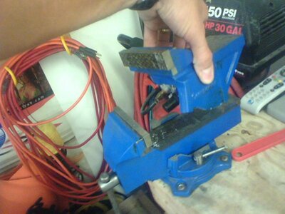

So I am taking the pump apart last night...
And Who does this.... WTF...
All in all, i got the thing apart and back together !
all done,
But heres more carnage !:ugh:
