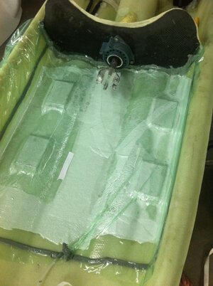

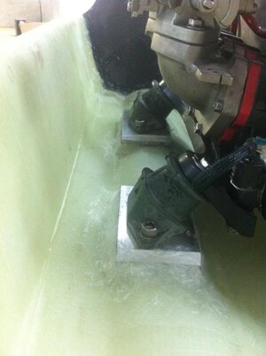

Quick update before bed. Another 12 plus hour day out here. The motor mount plates tacked up enough to pull vacuum on them with a few layers of glass for secondary bonding. They are not going anywhere!ImageUploadedByTapatalk1341632488.072129.jpg

Looking good man. It's amazing how much time you put in and how little progress you make once you actually pull the hulls out of the mold isn't it? Such simple tasks take WAY longer than you anticipate.

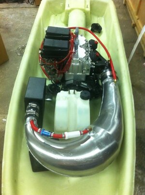

We both took vacation the second half of this week with this in mind, so after this things will slow down for us. But this was also help us figure out everything needed and get it down to a science. I think a lot of this time can be cut down if we get all of the small stuff out of the way, stock up so it's there come build time. This time around we had to make everything on the fly, motor mount plates, stainless nut inserts for all the driveline parts etc. If we bulk on those items and have them ready this will go much smoother. And we can spend more time in the air conditioned part of the shop!
Yes this is a glass hull!! Should have a great end weight if we keep on track here.
And its a thick glass hull. Bottom deck is 5mm thick at its minimum, with extra in some spots with beaching wear and landing impact in mind.
