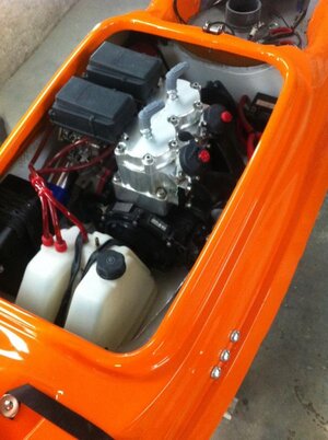

Ok guys here is where I need serious help. It starts up fine, won't really idle. Get it on the water and it won't rev up and get on plane. My front plug looks lean, the rear is wet.
Here are the specs:
8mm billet DASA pv 862
Dual 46 sbn
Riva intake
Carbon tech reeds
Power factor pipe
Msd total loss. 28 degrees static, 190 psi and 93 octane
Any suggestions for jetting and total loss would be greatly appreciated!

Figured out! Thank god it was something stupid. And yes it was stupid on my part for sure. This thing rips really hard! I never expected this kind of power. The boat is stupid short and light. It wants to come right around off a ripple in the water. I grabbed a handful of throttle and trim to see what would happen, I only have turf down on the bottom of the tray for now and there was no way I was hanging on. Josh has some footage he is trying to get uploaded now. I am fouling my rear plug, the front looks perfect. Then the battery quit. I need a primer too, I'm wasting too much cranking to get it started. Off to buy another battery now.

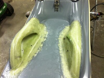

Rails are done. I saved the worst part for last. That's tonight's project after one quick ride now that I have a new battery. More composites on the way, and work to do on the Canadian freestyle bottom deck this week.
