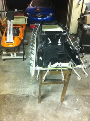

once we get a hull down here, we will be getting it assembled quickly and will make sure there is a build thread with lots of pictures and ride videos!
credit has to go out to brian and josh they are working like trojans!

Damn steve that hull is F-ing sick I can not wait for a build thread on this one

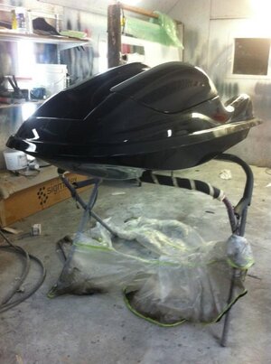

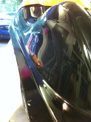

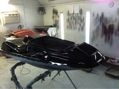

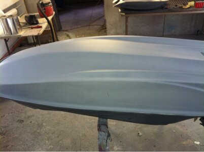

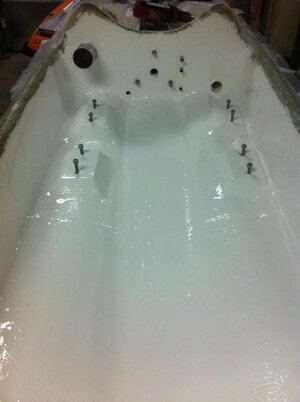

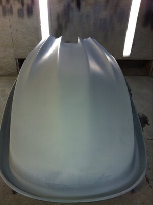

Starting with a layer of PPG epoxy primer. Fill pinholes etc wet sand and seal with the same PPG epoxy. Any base clear or single stage will work. First round we were shooting the primer in the mold, when sanding we found small pin holes that did not show up until the primer was sanded.
No more primer in the molds. Pop them out clear sand prime and paint from now on!

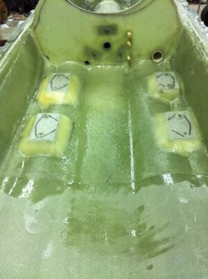

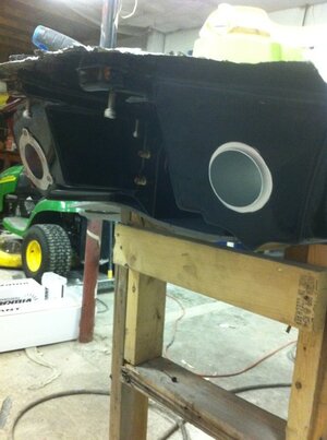

I can't wait to see what you do with it. And I can't wait to see what you fit in it as far as exhaust. Josh chose to put the waterbox where the battery would normally be. And just in case I did not already throw this out there, the PF power box needs almost 3/4" cut out of the bottom and re welded to clear the top deck and let the pipe clear the top deck. Sorry to say this hull will take a little creativity to make your setup work.
Oh and hopefully you have a 2.5 gallon kart tank ready. Nothing else is going to ever fit. She's a tiny one!
