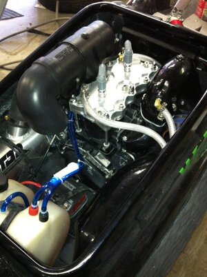

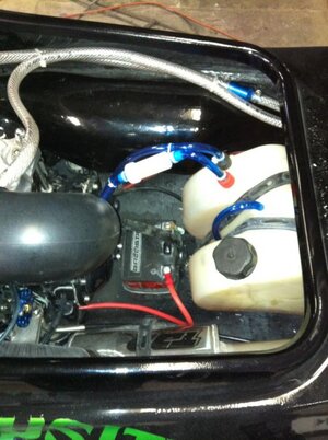

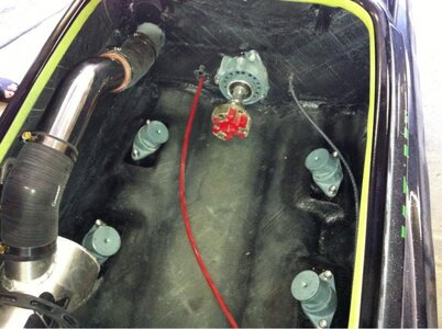

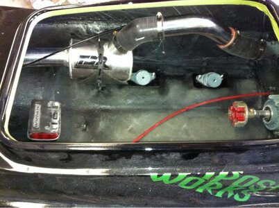

what fuel line do you use with those cart tanks. Aren't the nipples on them kinda small (considering they're meant to feed 100cc go-kart engines, not 800cc)?

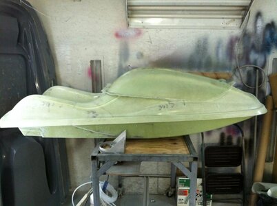

Also, what did you do to bevel the motor mount edges, I'm about a week away from doing that myself. and then what did you use to glue everything, I'm assuming it doesn't even matter much since you layed glass over them?
Stepped the edge on a mill.
They are glued in with thickened epoxy resin, using cabosil and 1/4 chop strand to thicken the mix

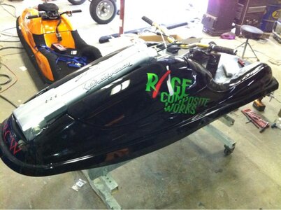

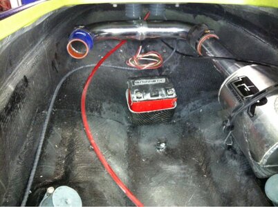

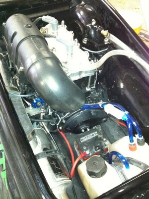

We got the motor in and all yesterday, splash of gas n she fired right up! I'll get some more pictures today, still need to finish turf this morning then it's off to the lake to test.

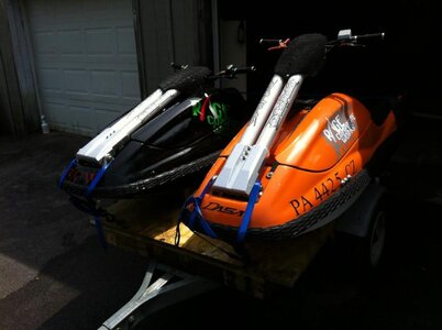

Did some water test on Ski 2 this weekend.
A Longer ride plate noticeably changes nose height and balance
Jetmaniac combo'd with Mag pump n 10/16 hooker hits real nice.
I'm going to adjust up the pole length some and go from there.
