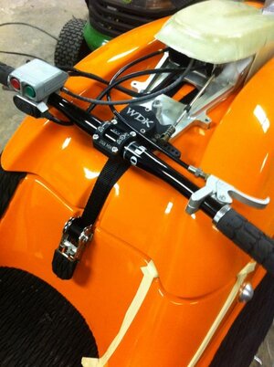

I put this on this morning before work. Love it!!
Tonight I'll be finishing the Canadian freestyle bottom deck, and laying up a hood and seal channel. Josh will be bonding his hull together. Later this week the Canadian freestyle top deck should be done and off to paint. I can't wait to finish the betas and take a little break.

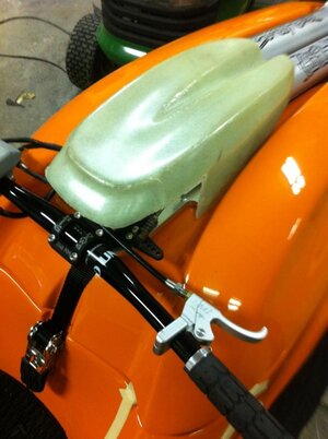

Sorry if this is a dumb question but does that pole pad come back further? It looks like its just resting there but if not i hope you have a good dental plan.
Ski looks great.

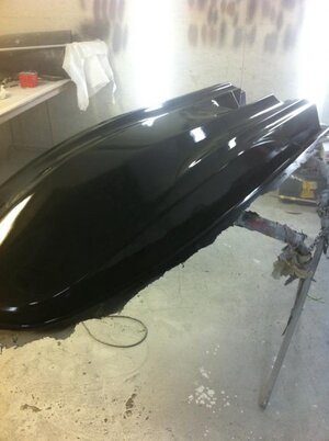

Mad progress tonight. Joshs is bonded, un clamped and the edge is finish sanded. Headed to paint.
Steve's bottom deck has all but the pump and rideplate inserts to go and it's off to paint. Engine mount plates are bolted to the jig and curing over night.
We are looking to be laying up another beta hull to have on display at the lake Erie freeride before we ship it out. (this will be Daralekts hull) It should be there in bare hull form so everyone can touch, feel and lift it around.
More work happened tonight at RCW headquarters... Steve UK can rest easy knowing his bottom deck is painted. Joshs top deck has a coat or 2 of clear on it and is ready to be wet sanded and sent off to his air brush artist friend once we flip it over and do the bottom tomorrow.ImageUploadedByTapatalk1343789898.968761.jpg

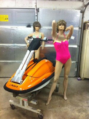

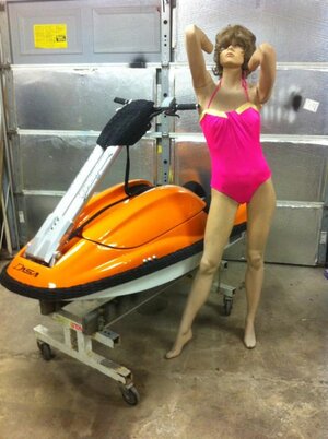

And I'm shocked nobody had anything to say about having department store mannequins in my garage??? I usually get strange comments when someone notices them in the garage bathroom. You guys are no fun!
I think everyone is waiting to see more pics and vids of this sweet hull
