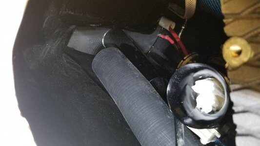

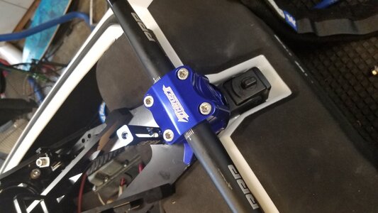

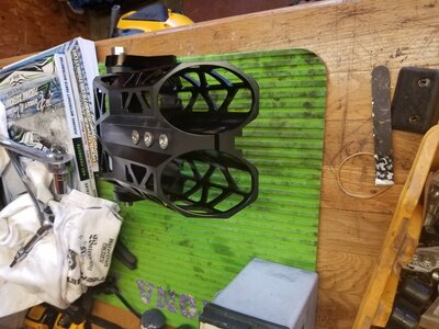

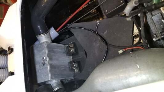

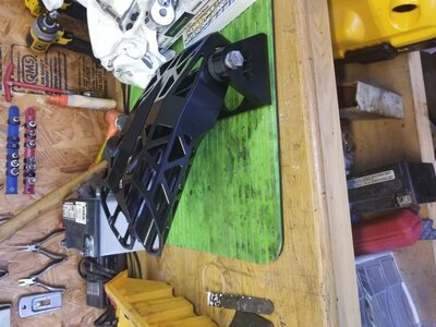

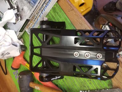

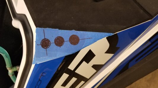

Started installing pole yesterday. Getting breather tubes up inside the pole tubes is damn near impossible.....20181103_123006.jpg20181103_123623.jpg20181103_124005.jpg20181103_123958.jpg20181103_124007.jpg

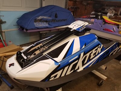

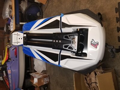

Yeah. Had to get a midshaft spacer. Got it in midweek. Got midshaft installed. Motor set in and shimmed. Started working on waterlines. Got to do it a bit differently from last build. Plus it is harder to get to up under there. I did get pole install completed. Had slight issue with pole bracket mounting holes being drilled out of square. Had to pull pole 3 times to try and get it straighter. Swapped to Thrust OVP. Smooth as butter.
hurry up waves firing at hugo. Looks like your close
Will mount EBox and Pipe tonight. Maybe get the waterbox set and hose installed. Hopefully Gas Tank tomorrow and run new fuel lines. Drill all thru hull fittings. Then sunday just finish tidying up everything.
