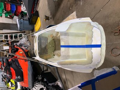

Got a lot done this past week/weekend. Shaped the new pole bracket area. Pretty happy with how it has come to form. Still have some low spots but good enough for now until I get deep into the finishing touches
The hull weighted in around 75lbs. (the hoist is 10lbs.)

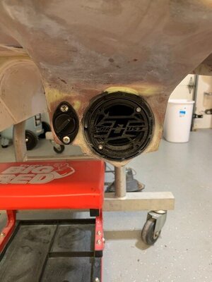

Been grinding these past couple weeks. Lots of progress but still ways to go. I ran into an issue with the PFP chamber hitting the sidewall. Instead of having the manifold shaved, I decided to make its own indent into the hull an build it into the tubbie. The rocker is fully on and reinforced on the inside with 4 layers of 1208 on the floor and 2 layers of 1208 on the sides.
