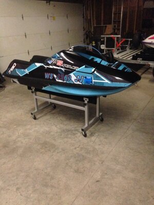

Late to the party apparently lol. I rockered, shortened, widened the tray and rails on my SJ last summer (http://www.x-h2o.com/index.php?thre...ete-rebuild-shorten-and-rocker.158734/page-11). Post-ride thoughts: Amazing in every single aspect except one; keep the rocker conservative or put on a splash shield. Mine blasts me in the face so much I'm gonna make a lip to screw on to stop the splashing. Mine is rockered so aggressively that every wake I hit it nearly forces me to do a 180 nose stab or attempt a back flip lol (key word attempt). Jumping wakes straight across is not that easy anymore :p

^^ i notice your footholds are really far forward, if you stood further back in the tray it would put less pressure on the nose, what are your thoghts on this
Honestly I wouldn't want my feet further back, it rides nose high as it is. The only time I get splashed is when I hit waves (quite often in our sport lol). If the water is flat and I'm cruising there's no splashing.

just read your whole build thread..you put in a crazy amount of work! gave me a bunch of ideas when i start digging into mine. curious about moving the foot holds forward though, did you find you liked it more forward or back in the stock(ish) spot? i know when you shorten them they will ride nose high so it helps to keep your weight forward.
Ya man it was literally 10x the work I expected lol. But well worth it! I purposely brought the footholds forward because I was worried that it would ride crazy nose high. And too be honest it's hard to say how I like them forward compared to further back, all I can say is it still rides a little nose high but I can also go WOT across a lake and it doesn't tend to Bob up and down like some hulls. As for maneuverability I really like having my feet a tad further forward, I feel like it puts your center of mass closer to that of the skis and it makes it easier to rotate the ski in certain directions. Keep in mind I could be imagining some of this but needless to say I will never go back to a stock sj hull ever again... It is seriously 100 times more fun to ride. Carves like surfboard with the widened rails, more height off wakes, not to mention 35lbs lighter than my stock hull. One thing I'd like to point out though, I think a huge factor to the maneuverability is the fact that I moved the pole forward like 4-5 inches in combination with a short handle pole. Sorry for the rant lol. Good luck with your build! I wanna see pics as you progress!
