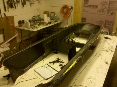

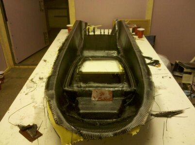

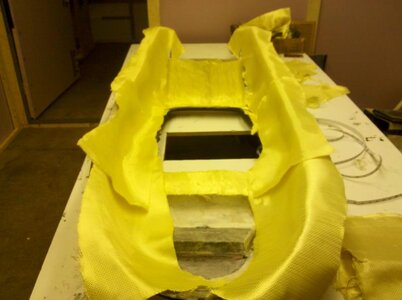

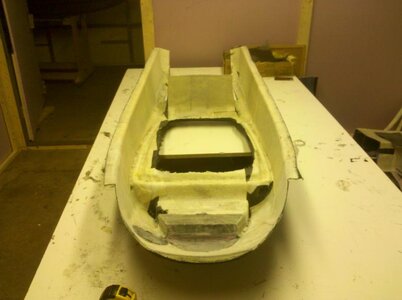

Well have a bit of a marathon session in the garage tonight. It's 3:30 am right now. Got the whole top deck prepped for carbon & kevlar, a layer of kevlar and carbon down on the whole top deck, several layers around the hood lip area and a bunch on the pole bracket and nose. I get to sleep for a couple hours then back out to tend to it as it starts to tack up. An extra set of hands would have been helpful tonight but oh well, need to get chit done!

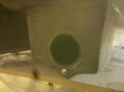

Update time.

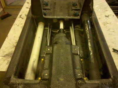

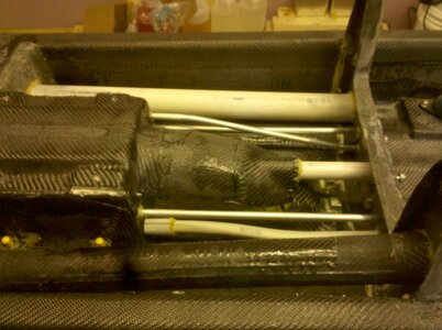

I had to add some reinforcements to the pump tunnel. I was going to start running cooling lines and noticed it was real thin in a few areas.
Attempted to make some carbon tubes for exhaust. First tube I tried vacuum bagging and it ended up creasing the carbon. Looks ugly but is still strong as crap. I sanded the ends and wrapped another layer of material around, followed by peel-ply and then electrical tape. This worked out well and left a nice finish.
The second tube I laid up turn out better, but still not totally smooth on the outside. I used 2" PWC for a plug, waxed it with some mould release and found if I put it in the freezer after the resin had cured it slides right out. I will try to use this piece in place of the long rubber exhaust hose.

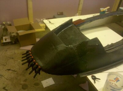

Got the through hull tube installed, pvc pipe for versiplug, and pvc for drive shaft. Also spent a fair amount of time fitting the top deck and mocking up some cut lines for the hood.

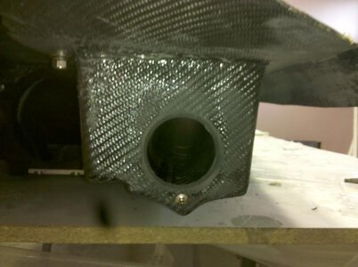

I got all of the plumbing run, added intake & rideplate inserts, drain screws, and finished the exhaust & versiplug tubes. Everything is now sealed up with 5200 but not shown in the photos. First time I've used that stuff... and it's f'n nasty crap. I had one of the wing nuts I'm using on the inside of the hull for the drain bolts to thread into move on me and I had to reach under the exhaust tube to reposition it and my whole damn hand and half my forearm got covered in 5200. Only took about a week to get that off lol.
