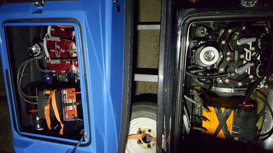

We chase boat wakes all summer, run 50:1and have single carbed 701s, 717s, 771s,964s,967s, and 1105s and havent siezed anything. These two in the picture get thrashed by lots of people all sumer. Hold them wide open or flatwater flip them. Give me your ski for a day and we could tune your single it no prob. Trying to talk someone through it never works. They all tune different.

Very Cool!!! Those arn`t cheapo turd motors either . What type of intake ,carb,reeds do you prefer ? how about baseline jetting , isnt the jetting similar on the exact same carb between 2 of the same size motors.
