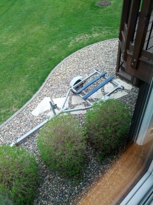

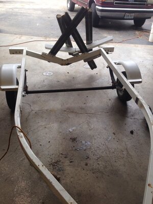

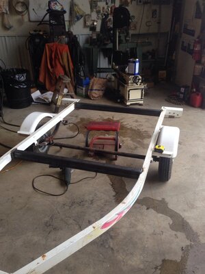

Great thread! I just picked up a Karavan single aluminum trailer to convert to a dual standup / single motorcycle trailer. I'll post pics when I get it finished up!

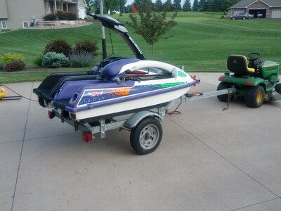

Mine is 44" between the outer rails, 12" tires.
-Rob

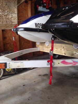

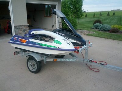

Mine at the moment I don't have any pics with the skis off at the moment. Just something I threw together real quick last summer to get them down to the river. But I plan on taking long hails this summer and need to redo and make it more solid. image.jpgimage.jpg

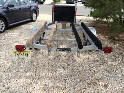

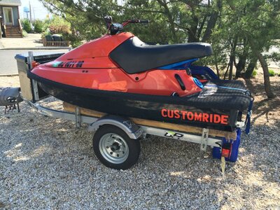

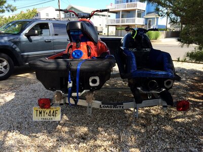

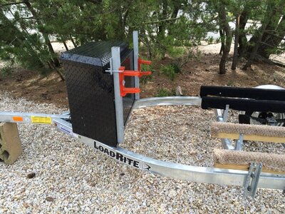

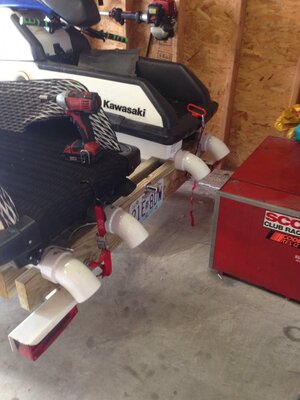

I wanted a 2-place trailer without the large footprint of your standard dual pwc hauler. I purchased a single pwc Load rite trailer, new, and began cutting. Its rated for 1400# but I wanted to do this without adding unnecessary weight i.e.. wood and be able to fit a blaster and sj.
For about $100 I purchased the galvanized swivel bunk and side bunk brackets with all u-bolts/hardware. The idea of using a tongue box was great from another member and is dual purpose-carry tools and stuff and keeps the front of the ski's locked down. Box was $200 from amazon. Lightweight but strong.
I ended up having more room width-wise than I thought I would. Verry happy with the results.
trailer (big wheels 14")-675
hardware-100
tongue box-200
total-- call it a grand

I definitely could've gone a more inexpensive route but this was an investment that I hope I can rely on for yrs to come and not worry about it on the road as I did with the previous budget trailer. Good thing is most trips are 2 blocks to the ramp!
Where did you find those brackets for the bunks? They look real nice.
I used these guys http://boattrailerpartsplace.com Theres lots of trailer parts suppliers. I used the edge- bunk brackets on the inner bunks of cross-frame and on the outer bunks used swivel bunk brackets withouts the swivel part. Just bolted the 2 x 4 where the swivel would go.

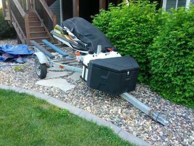

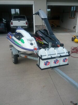

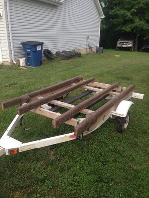

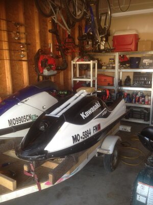

I converted my 20 year old single pwc trailer to a double stand up trailer.
Added:
Two bunks on the outside
Aluminum 2" square bar up front to hold the nose of each jet ski. Couldn't find galvanized steel without buying 20' of it.
Fly Racing 3 Fuel jug holder
Harbor Freight tongue box (~$100)
New submersible LED lights and wiring (old stuff was shot)
Will replace the bearings and wheel/tiries soon and keep one of them as a spare in the box.
2014-05-13 09.45.31.jpg 2014-06-08 19.17.27.jpg 2014-06-08 19.17.36.jpg 2014-06-08 19.18.29.jpg 2014-06-08 19.46.51.jpg 2014-06-24 18.36.49.jpg

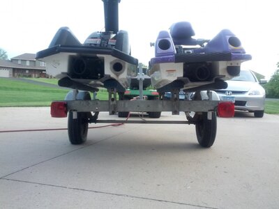

I have a Triton Miss Ski-tow converted to hold two skis. I know it fits 2 Kawasakis, but would probably be too small for a Blaster and an SJ. Anyways, I figured I would show you how mine is set up. I still need to get a couple pieces of aluminum to finish up the bow stop.
