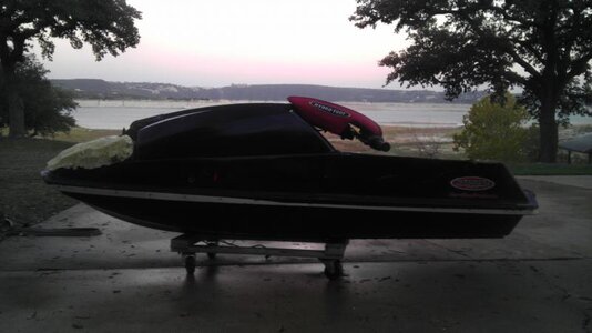

Heres basically what I want it to look like. The foam on the nose was quickly and haphazardly thrown on there just so i could get an idea of the look before i dove into it. It will be redone with 2 part foam and shaped later. Threw my fx1 pole on there for a mock up.

Its hard to see, but the stock hood is cut down. I may cut it even lower, I havent decided.

Took another break, used up the rest of my great stuff can so you can see what the chop looks like. Im not sure if i love it or hate it. I needed to lower and round off the corner, while keeping the height of the hood at the handle pole the same. If i lower the whole hood, the nose will end up looking too pointy. So this is hopefully a good middle ground. I guess we'll see! That great stuff is like trying to shape mashed potatoes :grumble:
