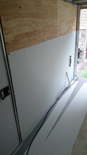

Next I started on the walls. I picked up some 4x8 sheets designed for showers. This would allow the walls to be wiped down and prevent my kids from getting slivers when camping in it. The sheets were mounted using J and T moulds, stainless steel staples, and glue. After the walls were installed, E-track was then mounted to the walls.

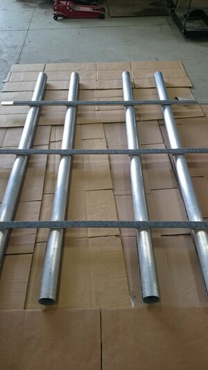

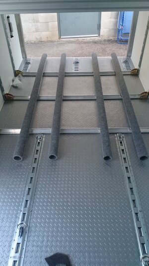

Next, the bunks the skis would sit on. I made the bunks span the width of the trailer and clip into the e-track which makes it easy to remove when the trailer is being used for something else other than to hauling skis. Aluminum angle iron was machined to pocket 3" diameter aluminum tubes. The rack was then welded up. Carpet was added to the underside of the rack and to the top side of the tubes (protecting the flooring and skis).

Time to test my measurements... they fit!

Very cool build, are you using Bow stops to pull the skis into?
I'm using a total of 3 ratchet tie-downs per ski. One across the rear, one pulling the nose of the ski forward and the other pulling backwards. The ratchet pulling backwards loops through a tie-down ring and hooks to the same tie-down loop as the ratchet pulling forward. This allows both ratchet mechanisms to be out in the open and provide ease of use.
