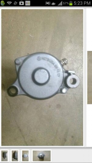

I thought mitsuba made the oem starters?
I just got this one. Was told its an oem from a 2010 superjet but it says mitsuba

The OP mentions $50 mitsuba starters in the first post. Are there cheap mitsuba and oem mitsuba different?
Sorry I understand now what you are saying now. Mitsuba are the oem starters. There are no $50. Mitsuba starters unless a cheap chinese knockoff is illegally using their name.
