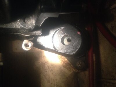

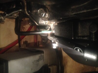

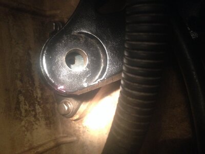

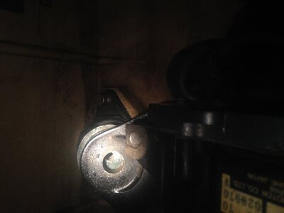

Ok so I'm off the pump situation, I'm expecting to be a little under propped and I can deal with it later.
I did notice something inside the engine bay however. Ive never had the motor mounted to the motor mounts because I've never had the bolts for it.
the bolts seem smaller than the Kawasaki which Is by design obviously but when I line-up the motor plate and the mounting holes, the drive coupler specs (no more that 3mm no less than 2mm ) from tooth on the engine coupler to the plate on the coupler on the mid-housing is way off. there is room for the rubber dampener to move back and forth quite a bit. here are some pictures to explain what I just tried to say.
edit: I cant get the coupler photo to upload but just imagine that you can move the rubber dampener front-to-back from coupler to coupler
also if someone has a set of motor mount bolts let me know.Ill ask live2ride hes in KC which is kinda close.

I also ended up finding some motor mount bolts and washers so the engine is bolted down and I shimmed it to line up with the mid shaft coupler.

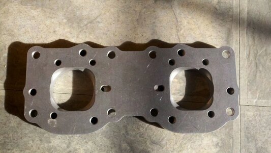

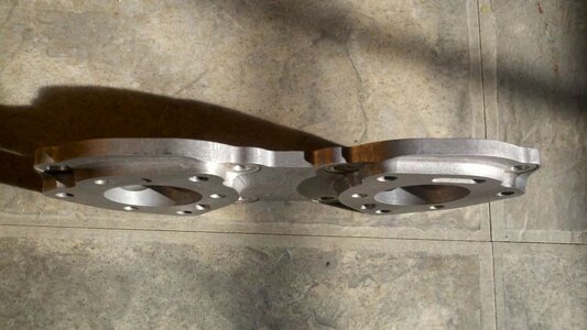

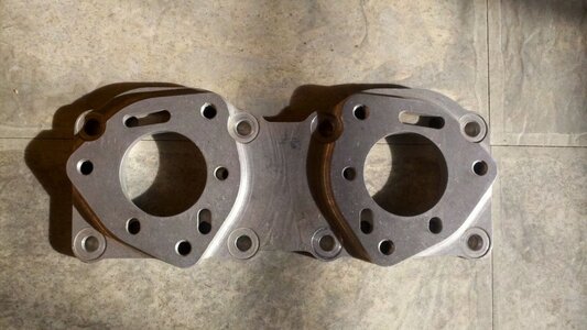

Ok so I got in my exhaust conversion plate. This thing is sweet! Just have to find hardware to clearance the new manifold. I did find bolts for the manifold to the conversion plate Though.
Here's what the plate looks like
Should be bolted on by this afternoon!
