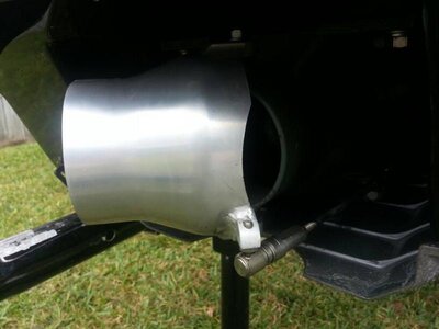

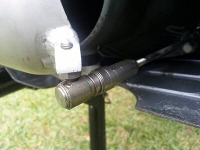

I have no idea where I got it but I just installed an OEM style cable end with a built in 3/4" extension. I was going to post it up for others but haven't been able to figure out which ski it came off.
I was using cable ends from sea doos which are longer than anything yamaha, but that was an M5 thread I think. This cable is bigger, and M6 thread count is different... I have to get more taps out to figure out what exactly it is.
OCD Solutions
Rentz, GA
This is what I used. It threaded right on to a factory Yamaha steering cable and was the perfect length. I've parted several Yamahas and only one Kawasaki 12F but can't find anything on any of the schematics that looks like it.
