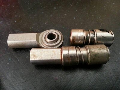

also, OCD if you figure out where that extension came from please post up. That would be perfect for my b1 with ATP nozzle.
I reinstalled my ATP nozzle last weekend and finally figured out where that adapter came from. I made it by cutting up a seadoo adapter and then tapping the threads all the way thru. The seadoo threads are larger as mentioned above but they don't go all the way thru so there's plenty of meat left to tap enough smaller thread to work.
