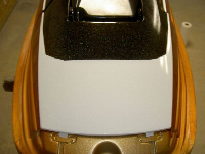

Well spring break is over :aargh4: And Im back to school:rolleyes: Good news is I got a lot of work done on the ski over break.
I dont have the time now to put it all up in step but Ill show of my paint job until then. I am getting in thouch with Abe at northgraphics and hopefully we can dress it up some more. Any sugestions??? As many know (due to all my anyoing questions) this was my first paint job and first time touching a gun. It turned out great in my opinion the only problems were when i rushed the clear coat at 5 am and gaot a few runs:17: It took 21 hours to do. I wouldnt recomend a tri coat for anyones first paint job.
Please let me know what you think. Im not sure were Imgoing from here but well see. THe turf is grey and the pole is powder coated black (ouch it was pricey).
Leave me some feedback and suggestions for stickers:arms:
Thanks-NICK

I like it! Super clean too! kinda looks like freestylegeeks ski right? with the metalflake? anywhoo, looks great!!!
