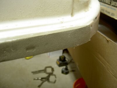

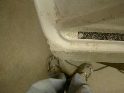

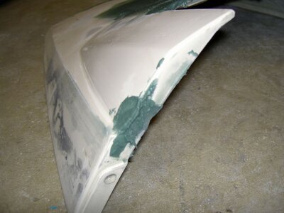

BILL Reinforcment and Stylin:cool2:
Goal:
Have a stronger more durable bill for my squarenose. Lose the ugly fuel door. Not spend 200 dollars on an aftermarket one. Repair broken edges.
Material:
WS404 Filler
Epoxy Resin & Hardener
Duraglass Fiberglass Filler
DolphinGlaze Filler
Mixing Tubs and Sticks
Old Magazine (I found it usefull to mix on a page then rip out and repeat)
3" Fiberglass Tape
Power sander
Sandpaper (2 sheets 180, 1 sheet 220, 1/2 sheet 320wet, 1/2 sheet 400wet)
2x4 (for wieght)
Step byStep:
  • Rough up underside of bill with 180 grit
  • Cut proper lenght fiberglass tape for lower sides of bill
  • mix resin and lay glass on lower sides
  • wait till resin is cured
  • Rough up underside and fuel door where you will glue it down
  • mix WS404
  • (I decided glass didnt make it strong enought so I put WS404 all over the under side)
  • Glue fuel door down
  • flip on top
  • Spread WS404 on the underside
  • - thin where you layed the glass and thicker too top
  • Let cure
  • Should be sturdy and strong :smile:
  • Use duraglass filler to "feather" in fuel door
  • Sand with 220
  • Use dolphin glaze to fine touch the "feathering"
  • Sand sand with 220
  • Sand sand with 320
  • More dolphin glaze
  • Wet sand 320, 400
  • WALLA DONE!!!!
Conclusion:
I originaly only planned to glue down the door, feather it in, and lay some glass underneath. I had lots of WS404 left over so I decide to try this. It worked great and fit on fine. I had two little high spots but I sanded them down quik and it works. I screwd it on with 2 stainless screws and washers in the front and two in the back. It feels like it is "at one with the sk"i lol.
