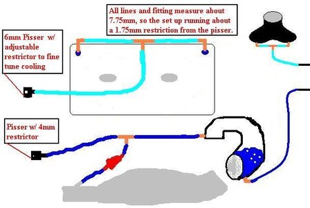

I am looking at Mcmaster and also on Atlantic Jetsports to get 2 decent strainers for my cooling system...
I have been thinking that a strainer with a collector bowl would be better than a garden hose with a little washer-strainer because it would take longer to get clogged and I can clean and inspect it easily.
I believe I should use a strainer on each cooling line in my dual cooling system because I will be using restrictors down stream from the strainers. The restrictors would become clogged much easier than the 3/8 cooling line. It would probably be MUCH better to trap any crap in the filter than have it somewhere in the line where I cannot see it...
I have never had a problem with clogging before, but I have never been running so many T's and restrictors and flow control valves and such like I will be using in this cooling setup... Maybe I'm paranoid?
I usually ride at inland lakes in ohio and once or twice a year up at lake Erie for a few days. Are the filters a good idea in your opinions? I would love to hear a few more opinions before I go spend $40+ on 2 little filters...
I also am going to purchase that Jetworks adjustable restrictor so I can easily fine-tune the engine temperature throughout the changes from spring-summer-fall... how do you guys measure your engine temp?
