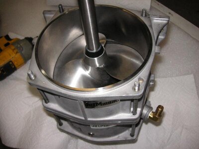

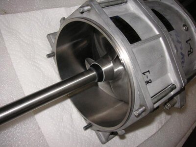

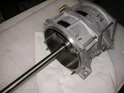

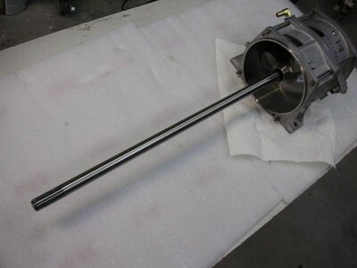

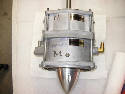

Scat 12 vein mag pump supplied by Jetmaniac, with 13/18 scat impeller.
