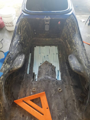

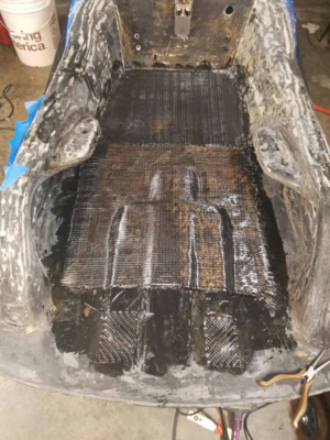

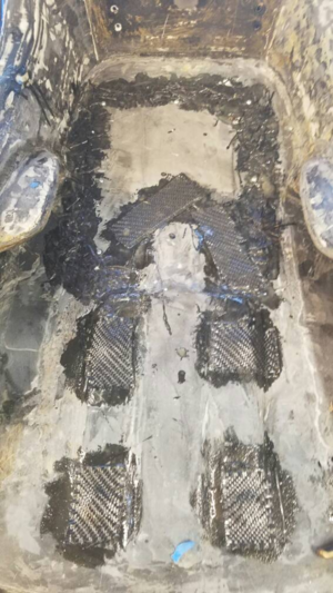

I also got an circus that needs new cooling lines, when the tray is cut open and ready to get put toghether again, how do you but back the cut out piece? Before laying new fibre on top of that?
Fill that area with foam panels or 2 part foam and sand smooth so the old sections can lay down on them for support. then class in with resin. I had either 404 or 405 adhesive powder to the mix (West Systems) 1669130655399.png1669130655399.png1669130496585.png1669130554039.png
I am going to use small bits of 2 part epoxy to set the parts in initially, use chopped carbon/resin to fill the gaps, then small pieces of carbon to cover the gaps, followed by a larger sheet over the whole thing...maybe one more layer depending on strength
I cut my tray open to inspect the lines on mine. When sealed it up instead of using foam, I used 4 layers of 2 inch glass tape and made some strips that I riveted under the tray that I could lay the piece I cut out to glue back in and laid some glass over the entire tray to reinforce it so I didn't have to add any foam.
