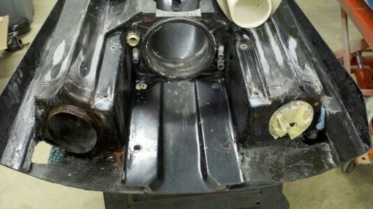

pieces of Alum that run parallel to the drive shaft tube , they add support to the tray and seperate under the tray area into three seperate compartments
RMBC Freeride
Vintage
Pueblo, CO
Chad, pc of alu running parralel with the drive shaft tube (along the ski) or across in the freaks? Wonders why it isnt carbon?
They don't look like aluminum in my Freak. I can see the stringer boards where I cut into the tray. I think it is some sort of foam board like divincyl or a composite board of some sort.

Haven't put much time into this lately, but made some progress today: inside is tabbed in and reinforced with carbon, outside is reinforced with carbon, and I trimmed off the back edge. Now time for much sanding, shaping, filler, sanding, shaping, etc...
Looks like a nasty mess right now. :(

I made fairly large cuts in the tray which allowed me to get in there and lay a couple layers of carbon in the rear corners to help tie it to all back together.
