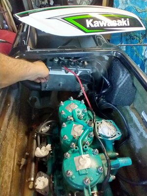

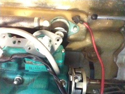

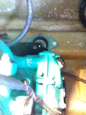

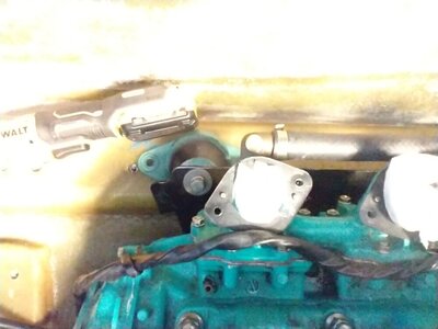

Playing with the engine mounting some more what do you guys think about drilling and bolting through the white dot here? Is that enough contact between bedplate and mount? Put another washer behind the coupler to buy me another mm?
Or should i suck it up and drill new holes.

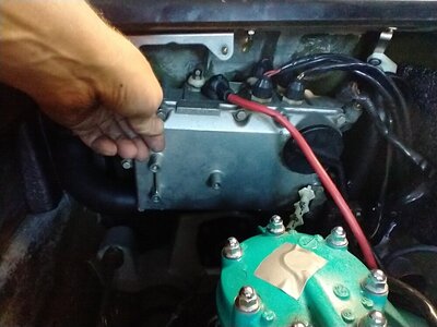

Back of motor:
And any suggestions on where/how to mount the ebox? Thing weighs a ton too. need to do some searching and see if its possible to shove it all into something smaller.

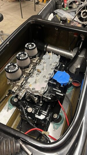

Pic I stole from FB:
They
They got it to fit. But ran all those hoses and lines like a crackhead? Maybe I'm ocd or something but that screams backyard built to me.
Can you mount the ebox to the engine? Looks like a bit of room.
Can rhass make you custom motor mounts? Can you source a different style mount and drill new holes to match the sxr pattern? Can you tig weld good enough to add a piece to the bed plate?

Personally I wouldn't drill holes unless you plan on welding the bedplate holes up and then redilling the holes, I would find a thicker washer to put on the crankshaft and one on the driveshaft and think about putting a seadoo driveshaft snubber inside the impeller, that might give you just enough extra to line up correctly.

I do have a question though , can you redrill the holes where the bedplate mounts to the bottom of the engine or is there room to do that , When I put that 720 Seadoo engine in my X2 I welded the engine mounting holes up on the 650 bedplate and redrilled them to match the 720 pattern plus I had to heat the bedplate and bend it to clear the starter motor.

It looks like the oem mount area metal strip goes the full length of where the motor mounts are. So going to drill and tap new holes so everything lines up. *fingers crossed* If not I have plus nuts to stick in there.
I do know the plates extend farther out than the mounts, not sure about full length, I remember a thread where a guy robbed a ZXI 1100 of it's engine and installed a 750 in it's place, he had to move the plates on that one , but no farther than you are off there should be aluminum there.

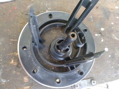

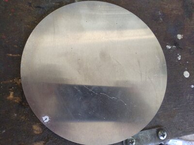

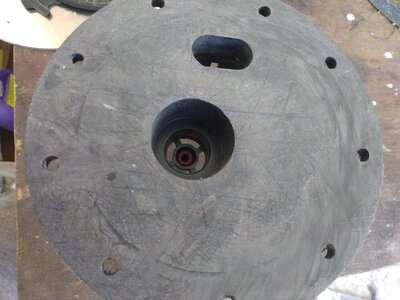

I got my two discs in today and am starting a couple of DI to carb conversion plates on a couple of Seadoos, I cut and ground off anything that was sticking up on a stock fuel pump module till it would sit flat on the disc and I will use that as my drilling guide. I think I am going to use stock 750 Kawi pickups on mine so all I have to do is drill a hole with a hole saw and drill and drill and tap the mounting holes. But I may use a ZXI pickup so I won't have to have a separate petcock.

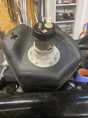

I wish I would have ordered a disc for my sxr 260 project . I plasma cut this one .

Yeah the 6" disc was almost the perfect size for this one, plus I suck at cutting circles that remain circular.

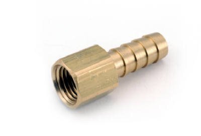

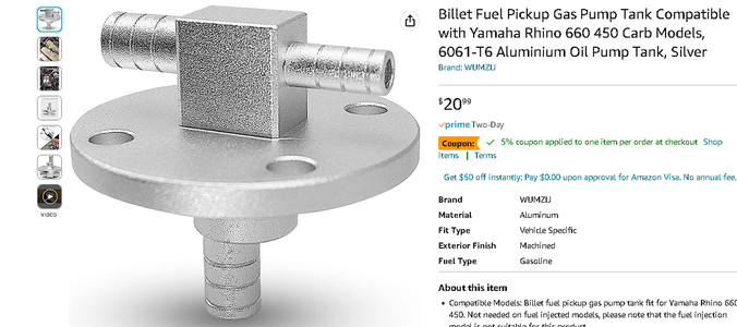

Thinking about this some more and remembered that my limitedslip tank had these:
If you are going to do that maybe just use 90 degree hose barbs and these on the bottom with in-tank drop tubes and clunk pickups, sandwiching the 1/8 "plate between the two if you get what I am saying, tap the plate install the straight fitting onto the 90 degree fitting and attach hose and clunks .
