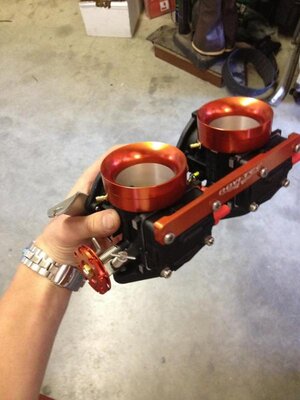

New Novi Dual 48 limited edition black carbs thanks to Thrust Innovations!!

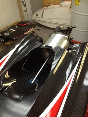

Thanks Hydro! I have ridden the Dasa 885 with Skat Mag 148 and it makes a huge difference. I would flip that set up where the same hull with 950 dasa but stock pump I could barely flip it and stuffed the nose most of the time. I will certainly go over all the details of how this set up feels. Right now I am awaiting several parts still. I had my ignition wired into the RRP box by Mark Baxter at Power Factor Products and that will be back here monday, I am also awaiting my trim system, and a few custom parts from Rickter in Thailand. I am also awaiting a bunch of small OEM stuff. and now I have run into a problem, my driveshaft is almost 1/2" too long. Thanks to Cold-Fusion I am having a custom spacer plate made to move the midshaft forward enough to make up the difference and get the pump seated properly to the pump shoe. It was quite the headache to understand what was holding me up but with lots of measurements and talking to some awesome friends and supporters of mine, TC Freeride and Cold-Fusion, we sorted out what is wrong and can fix it. So hurry up and wait!!

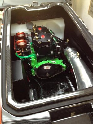

but in the mean time I had to go do some mock up!!

my driveshaft is 1/2 inch too long. It is not the hull, not the splines or midshaft. it is a driveshaft length issue. But it is being fixed and it will all be good

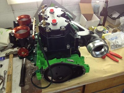

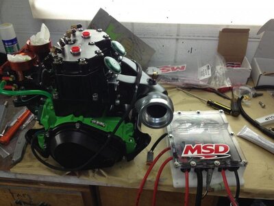

Well I got my VP C12 race gas today, the MSD ignition is timed to 30' and motor is ready to rock. I also used a kawi bilge switch for my ignition power switch and mounted it onto my billet RRP pole. motor should go in tomoro evening if i get one more part!
