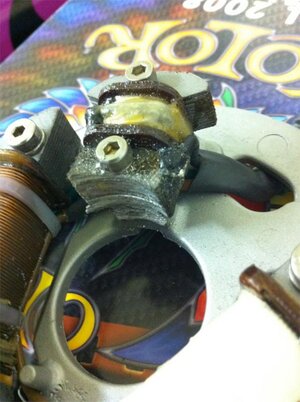

i dont believe ryan has a 61x stator , he said it was off a 97 sj so unless it was switched by maybe previous owner but i doubt it . i believe it was machined to much which allowed it to go on further than supposed to possibly
RyanITV
Living on the lake!
Lewes, DE
It's a 61X (so says my receipt from JSS and the marks on the unit) - must have been switched by one of the prior owners. I'm pretty sure when I bought the ski from Pancake he hadn't been into the motor.
Ryan,that explains the wear on the hub where it was hitting the stator,was there any wear you could see on the back the hub itself,cant really see in the pic. can you push the key through it with a tool now?

The square "blocks" in my photo were just metal shavings - I guess they stuck there - they wipe right off.
