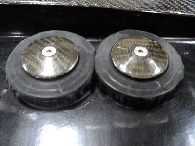

Here's my futile attempt at water ingestion. Outerwear Prefilters over grates. Instead prefilters on the carbs, figured why not on the hull, keep the water out in the first place. I used dished washers to "pressure" mold concave retainers. Rod couplers inside of plenum retain everything.
