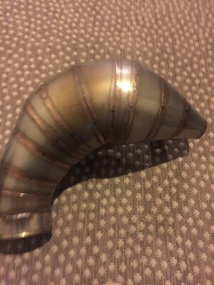

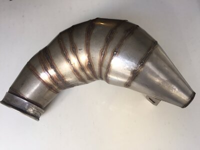

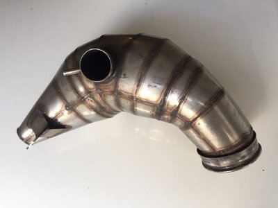

Tim, I don't want to gum up your thread but I just scored this piece of your history and I wanted to see if you could ID the chamber. Bought from an old racer in Colorado, and it sat on the shelf since you made it or so the story was told. He told me it is a Superstock chamber, hoping so, to use it in my surf ski.
Thanks and seeing your craftsmanship in person, I wanted to give you props on building the new version of these pipes again!!.
That is in fact an early super stock chamber.
I had power pros making them and that's one they built.
nice thank you! for the info. would this one mount eith lord mount for c4/rad dudes? off of flywheel cover bracket. Only asking because it seems low, almost inline with flywheel bolt.

Yes it will mount with the rad Dudes mount as that mount they make is a dead copy of my old mount bracket.

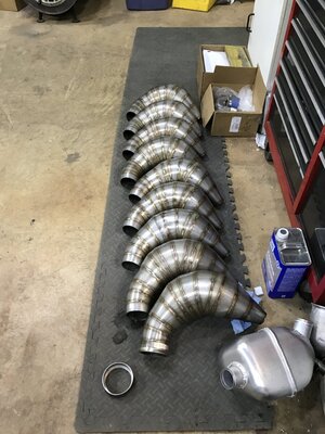

Everyone who been waiting for there pipe.
Thank you for your patience.
I have been going 18hrs a day 7 days a week for the past 6 weeks.
I will have all the pipes completed and the last of them out in the next 10 days.
I also have 50 more patterns and am going to make some for stock so we can kill this 6 month lead time
