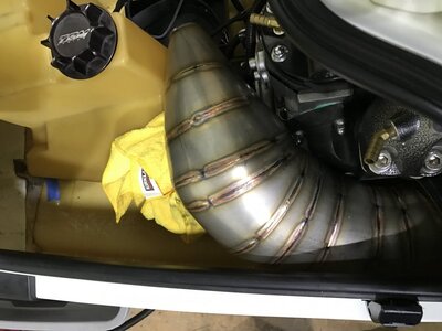

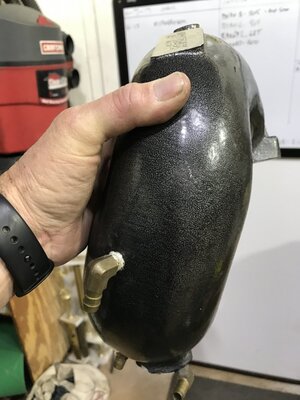

Here two pictures of where we drill and tap for water routing. Water goes into very bottom fitting, 80% water comes out in the new fitting in the back, last 20% water goes out the top.
Change the restrictor in top to add or reduce water flow.
More water out the top less the motor will rev and pull little better on bottom

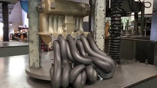

Tim, i used to hear the term extrude hone way back in the day. Some peps on here might not know about that. Is there a company doing that?
Extrude Hone. It's the company name. They cap off the end of a part and squeeze an abrasive goop through it to smooth out the interior. In our case it removes the casting roughness in manifolds and adds performance. Many of us old-timers have been using them for decades. It's far easier than trying to polish an entire part, especially something difficult to reach with porting tools like a headpipe or long manifold.
https://extrudehone.com/
https://extrudehone.com/products/abrasive-flow-machining-afm
Is it safe to assume this routing works well with a bpipe sj mod/limited chamber as well?

That's an old stroker chamber that Simone cut and did a limited spec tune length.
Then they rand head pipe dry and water into chamber.
You can most the water better with multiple spray and they do respond slightly better.
But it's tricky
