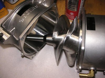

Solas MAG Pump and midshaft for BB build
Solas MAG pump and custom length driveshaft for Solas
Pump built with shorty freestyle cone installed
Ready for impeller install
Hooker 10/16 installed and properly shimmed, all SS Solas 'forever' wear ring install
Finished Solas pump and midshaft ready for install!

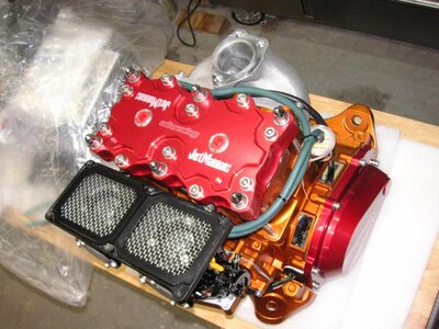

Customer loves his BB781 but it is upgrade time so we just built him a new PHP/JM 937. Motor has fully blue ported cases and epoxy work with billet PHP top end with new lightweight 4mm crank and lightweight pistons as well.
PHP Red Motor (1).jpgPHP Red Motor (2).jpgPHP Red Motor (3).jpgPHP Red Motor (5).jpg
The machining, detail work, and anodizing on these cylinders is high quality.
PHP Red Motor (6).jpgPHP Red Motor (7).jpgPHP Red Motor (4).jpgPHP Red Motor (21).jpg
Love the o-ringed PV's, no more paper gaskets to replace every time you pull power valves.

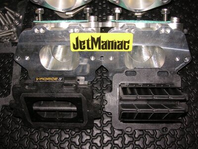

Intake Package for PHP flatwater setup:
Novi Freestyle 48s, PHP billet intake manifold, VF3 reeds/cages
Installed intake and reeds
