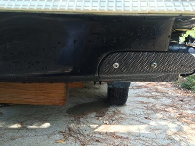

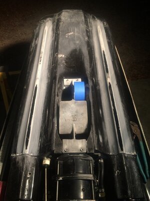

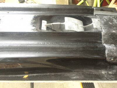

Well here you go...so basicly I got a wild hair and decided to shave down the hangy down things . I ended up taking off about 1/2 inch on each side to match my Tweaker ride plate.
The net effect was outstanding ! It made the ski MUCH easer to slide and break loose. I was a little concerned it might be to loose..... Not at all it still rails in a turn . Not quite as hard as a stock chan but still very well.

No need to be a negative Nancy. Hard for me to tell you its too much money if I don't know the price. I'd give you $176 for one of these chine free plates, but a few questions first.
How many Chan's have you tried these on?
Do they fit well or do they need to be fitted some? Some fitting doesn't terrify me, i'm just trying to understand why they wern't sold before. I assume the reason is universal fitment but I have no idea.
Are the holes beveled like Steve's plates or are you using button head hardware?
