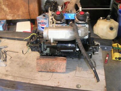

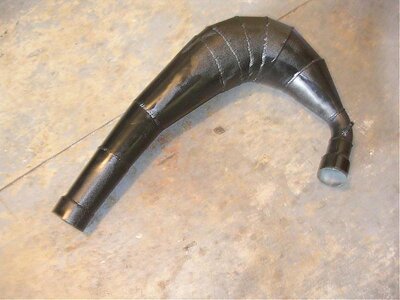

Advise please, what to put the screw at such motor, what pipe and a final collector?
Look into using a stcok gp800 pump w/ a superjet drivehaft installed or for more performance a mag 148 or 155 pump. Waterdawgkustomz.com has pipes, exhaust manifolds and intake manifolds for that motor. They also have billit brackets to bolt that motor right into a superjet using the stock motor mount locations.
GDFL. I already wrote to them, the answer is not present. Four days has passed. Was on their site, not enough information is not present collectors and pipes. As I do not know what to put the screw.

The larger diameter pumps require larger pump shoes what are also available through Waterdawgs. He is in the process of updating his website and will have pics and prices available soon. Jeff Curry at Waterdawgs is the main source of information on this modification. Send him a email and he will supply you with the specific information you need. jcurry@waterdawgkustomz.com
a 66e with the following will net excellent results:
Exhaust
Dual 48mm Carbs
Billet Head w/35cc domes
gas valve conversion
adjustable cdi or total loss
had a similar set-up in my gp800 and i was making the neighbhorhood of around 140-150hp with out going to a big bore set-up
