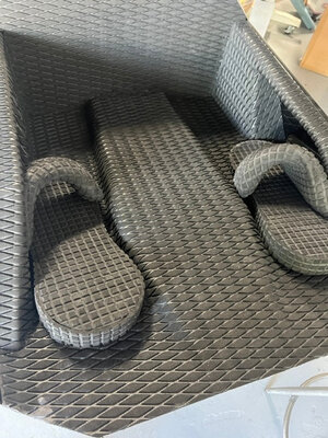

Seems like one of the latest foothold trends look like a step in slipper. Make prefect sense. Are these available separately? My neighborhood cobbler needs a job. ha ha
Got Dakine footholds (good start), just need souls integrated
found them: only um 400$ bare!!, I'd feel guilty buying these... 2 afternoons of glassing.

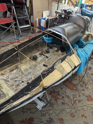

Good, bad, and ugly. Had to take a side step to correct an epoxy lower case. It's kinda disappointing when you pay 5 digits, you would expect this not to be an issue. Seller shipped poorly and damaged plate.
Marine JBL, prepped in/out. Guides from Rick (X)

Why do that to an fx1? I think this project would be perfect for a sxr1500 hull. You have a lot more real estate to work with. It looks as if you're making a fx1 (rare desirable hull) and turn it into a x2 with a katana seat. I'm all for innovation and creativity but I'm a little saddened to see this done to something as special as a fx1. At the same time, I'm intrigued to see how you make this work. I just hope it actually gets completed because I do enjoy seeing builds get completed.

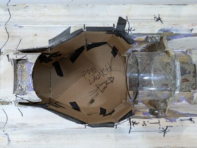

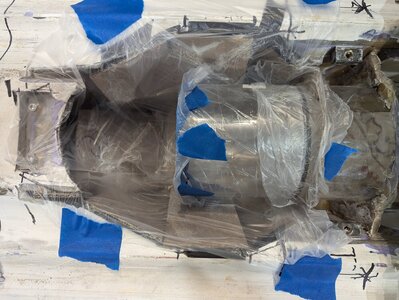

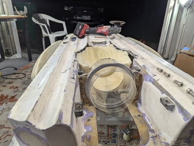

pre form. smooth transition, no turb (122mm to 160mm tunnel)
tunnel will accept 45% approach w/worx 701. With what 'she said' shapes
Fair and relatable. Don't know the sxr1500 hull. Only had experience modding Superjet hulls. The FX1 is (as I understand) a bit slicker w/ chimes. Now, I'm opening to 160. The extra sponsons allow the magic. Dig and drift
The sxr1500 is pretty large for a standup with all the room for the biggest engine you could stuff in it. They're excellent in chop and carve like no other. They're pretty cheap to find as people take the guts out and put them in the kommandor or pro watercraft hulls and go race.

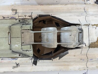

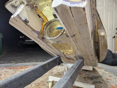

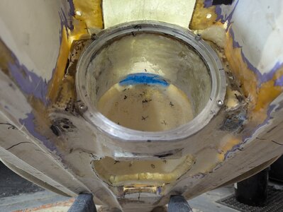

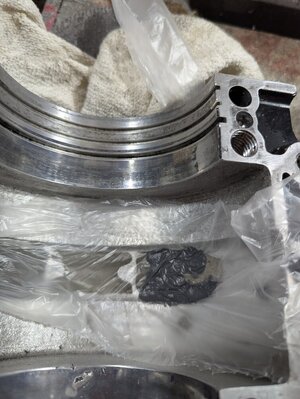

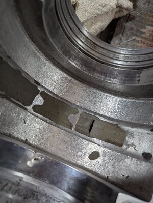

Roughed out tunnel, patient is in recovery.
Interesting technique; surprised how well chopped strand/cabisol can make the ultimate structural filler.
Micro balloons additive to epoxy can simplify tunnel sanding.
No choke intake, 160mm + smooth hydro @ forward and 45 approach.
I'm so reinforcing the hull (@strategic points) to cage the beast
