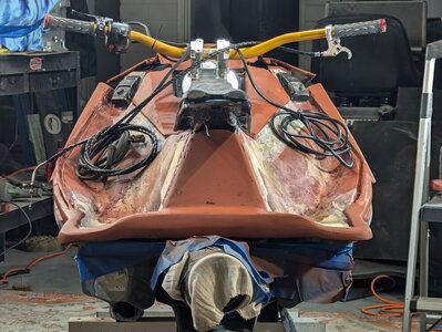

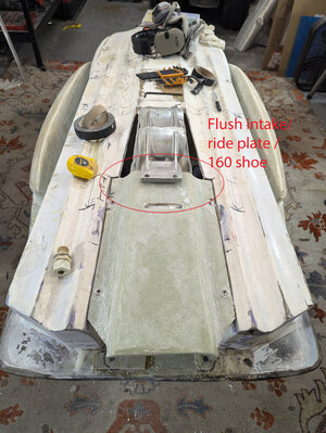

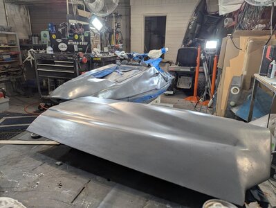

We are going for bra-pp: this ungodly 160mm ring and tunnel has been adapted to a small 'precious' FX1 hull, should be illegal in most states.
Fabrication: 1708Biax upper tunnel shell
Microspheres epoxy inner tunnel (hand sands easier)
Chop strand / Cabisol epoxy for structural mods

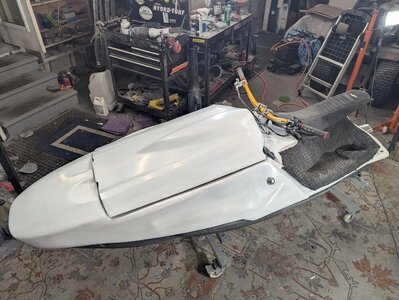

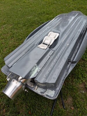

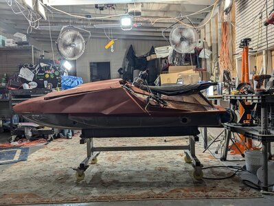

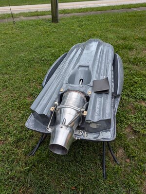

Wow, a couple weeks of late night fabricating. (reminder: 120mm to 160mm FX-1)
(code cryptic; regards to center lines; installed pump/torqued pump/ 'tap on shaft' hear CF Mid shaft tool coupler loose raddle......meaning....alignment. )
It will be so confusing, if...IDK

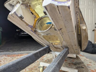

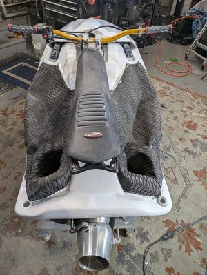

timing, here's her bottom.
Low low is right, now shift your body laterally into a turn, while keeping the craft even plane. Couldn't help but add... now you are drifting, my earlier protos were 701's enhanced, 964 TPE's, 1K Xscreams, now 1.4K Xscream.
