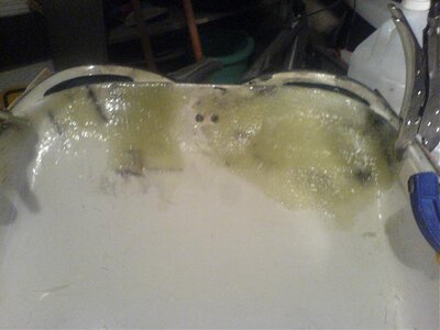

It seems to be working out well.... time will tell though. We will see how it stands up to some abuse. I dont know how tough this thing will be at the bond between the liner and the hood. I got a lot of epoxy down in that gap, but I was thinking of laying some thin glass over that lip perhaps as added reinforcement..... but maybe all that epoxy will be bulletproof as it is....

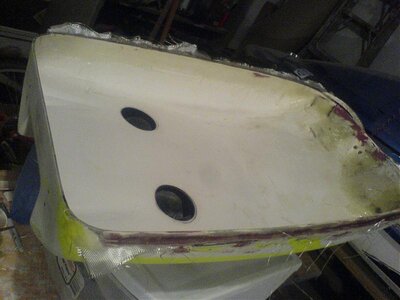

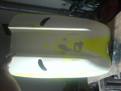

I think we originally both thought that the glass would be good on the large areas of repair around the breathers like I did in the pics above....but we thought the epoxy would be strong enough to bond the sides... but after looking at it all done I am not sure... we will see what he says.

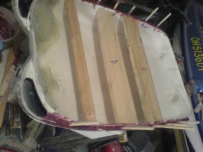

got it going back together now...

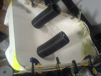

Made braces to get the hood at the right width across at all locations. Then spaced the hood away from the hood liner with dowels on equal locations to insure the hood itself was spaced the right amount away from the liner.
I mixed a bit of filler and epoxy and jammed it down in the new large crack.
When that dries I will take out the dowels, sand the channel to be flat all the way down both sides, fill in the holes from the dowels, lay glass in the channel all the way down both sides, trim glass, take away the braces, DONE... hopefully only one more day of this crap.

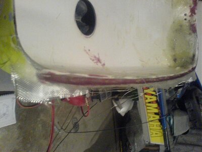

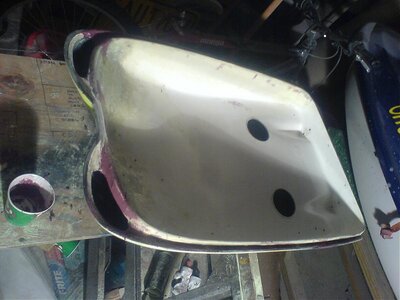

tomorrow I will trim excess and sand the hood a little more before it is ready for paint.
The hood fits well now that I used the bracing from the prior pics to insure its correct shape while doing the repairs this time....
