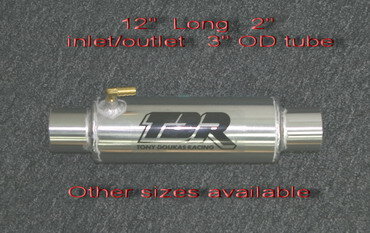

I am about to run one these waterbox's/resonater that i bought from TDR its a 3.5'' center can with a 2 1/4'' inlet to a 2 1/2'' outlet as well as a water inlet. One of the other members on here (RAGS) was running one of these and he claims that if you mount it on the ski at an angle it works really good for back pressure i have not messed around with it yet. will it be loud probably but its a jet ski. How many flat bottom boats out there are loud? almost every single one. r3.jpg

The best waterbox IMO for a yamaha tripple conversion is a raider 1100 waterbox #1 (there's two boxes in a raider, so make sure you get box 1). No modifications to the box required, and the inlet and outlet are the right size for the motor, no backpressure issues.

Skateboarder thing is dead on. Yeah i fired the ski w/o waterbox today just on starting fluid and only fired for a second before i turned it off. Didn't give it a chance to run. I ran to change my pants because that Sh*t is loud. Sounded like a 450f dirtbike which =AWESOME lol. I have a small 700raider waterbox i will trim and fit and see how it sounds. Going to place in water tomorrow on trailer just to give it some run time and that way the water quiets the exhaust a bit.
(Danman108) And would that resonator keep water out of the engine. I dont care about the exhaust being too loud, my concerns are protection and keeping ski in great running condition
