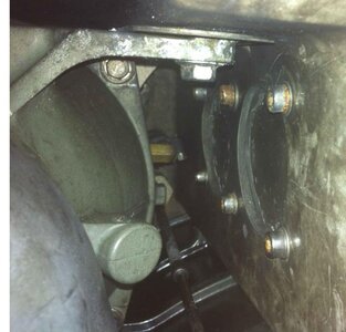

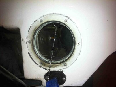

We fitted the dual ex outlet from an 1100 raider to the opposite side of the pump cavity to keep the correct Ex size all the way through. Als fitted the extinguisher cover to the rear of the hull to make access and fitting easier. keeps the ski running well and nice and quiet.Ex.jpghull.jpg

Oh interesting ideas. If have any other pics of the ski and conversion id love to see them

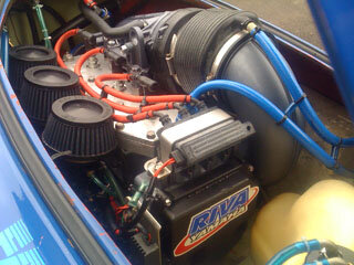

It's blocked off because I'm running a Dasa 850SS in that hull at the moment, so using the standard outlet. have a couple of photos when it was running the 1100.engine.jpg1100.jpg
