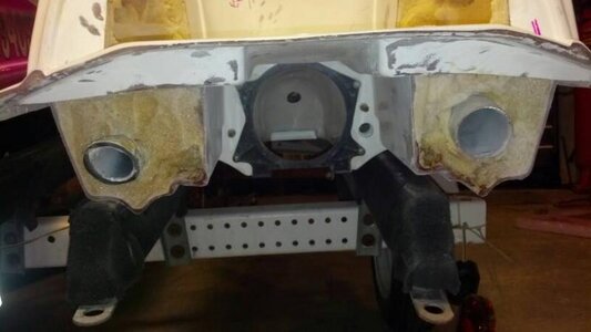

So other then that tube not connected to :):):):) can anyone tell me why the one mount is higher in the front then the other one?

picture didn't dose not really show but say you looking at the front of them the left side is 1" taller in the front only back is same at same measurement as both ends on the right side and all the other Rev hulls i look at non of them show these for engine mounts its crazy im lost on that maybe someone else can answer?

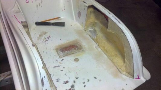

Rev hull fully defoamed and getting ready to fix all the f**ked up spots with glass then lay in some foamular 150 extruded polystyrene (xps) insulation pink foam and build the tray back with new BOB footholds.

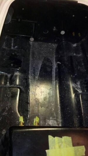

So this piece of crap is delaminating in side tray and in the bilge floor were they attempted to lay carbon fiber wow what a pile of :):):):) thinking about having a big bone fire tonight.

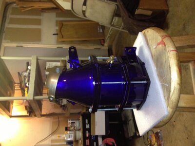

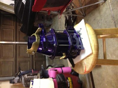

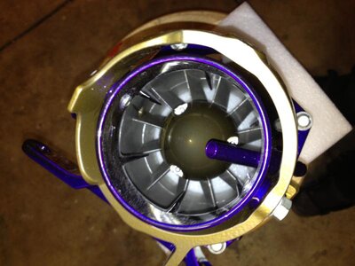

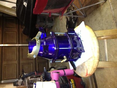

the new solas 12 vane pump powder coated it with Candy Purple and Transparent Brass IMG_0151.jpgIMG_0152.jpgIMG_0153.jpgIMG_0154.jpg

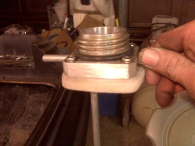

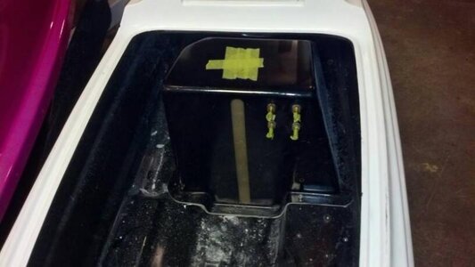

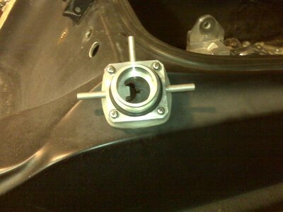

blowsion kawi fuel fill cut kawi tank apart and going to put in sj tank IMG00191.jpgIMG00190.jpg

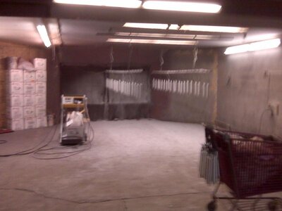

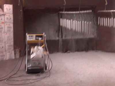

my powder coating booth/shop IMG00194.jpgIMG00195.jpg
