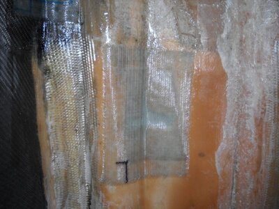

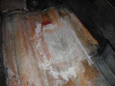

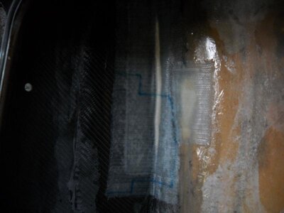

well today got the start to some holes patched in the bottom of the hull just layed up 2 layers of 1708 on the inside of the hull still waiting to dry. i will also be laying 2-3 full length layers from nose to bulk head on the floor to build it back up. Then i will flip the boat over and lay one layed of 1708 and a layer of carbon and vacuum bag it. Since i will be paint boat read and white i was thinking about buying some white hybrid carbon/fiberglass to use on bottom. will post pics when dry

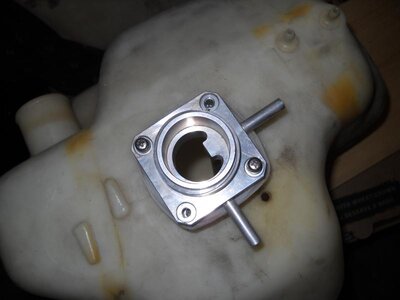

I was talking about the black gas tank. Is it glassed right to the bottom-deck? Seems like a good idea, no issues with a gas tank breaking loose and spreading fuel all over the hot motor.
The tank actually has a flange all around the bottom and it is bolted to inserts in the hull.

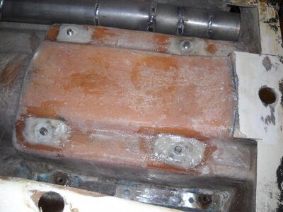

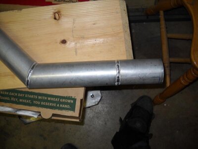

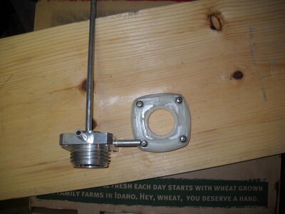

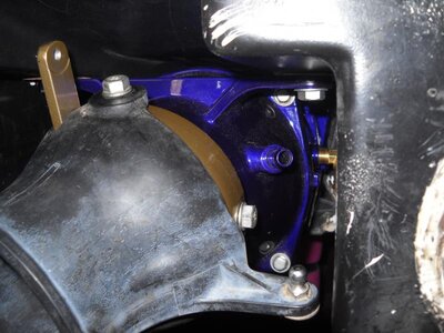

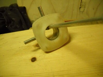

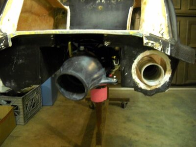

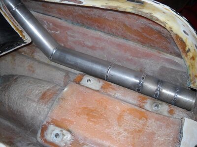

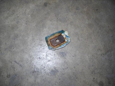

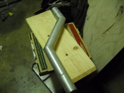

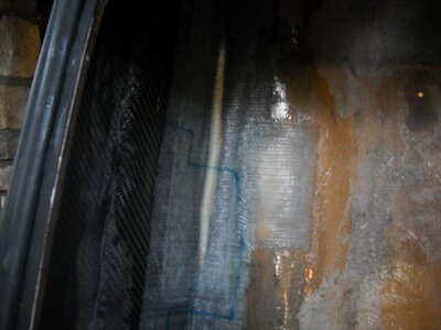

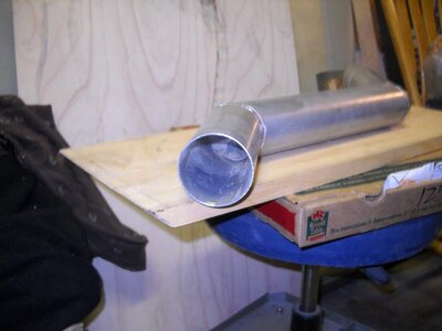

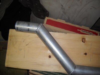

So today i got the boat all cleaned up patched holes in the floor of the hull and re did the pump mount inserts as well and go the exhaust pipe i made half way installed. here are some pictures of my progress. DSCN0531.jpgDSCN0537.jpgDSCN0538.jpgDSCN0540.jpgDSCN0541.jpgDSCN0543.jpgDSCN0544.jpgDSCN0545.jpgDSCN0551.jpgDSCN0552.jpg

Found out the engine bay liner was :):):):) and had moldy foam under it so i ripped it out. Installed all my own inserts and wrapped the entire engine bay in about 3 layers of carbon.
